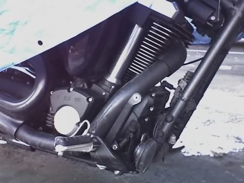

Does this work?
Old 01-12-2007, 11:53 AM   #14
FastCat's Avatar
From: nowhere, wa
Originally Posted by devnull View Post
Does this work?
Yup - that works fine.
Dude, for what you're doing, just order the new part(s) from your favorite dealer, and in the meantime drill a small hole in the end of that arm and use a M6 or 1/4-20 bolt with a couple nuts and flatwashers to make a new "pedal" on the end of the arm. Yeah, it will look frankenstein, but you'll be able to ride safely while waiting for the pretty new parts to arrive.
Old 01-12-2007, 01:36 PM   #15
AnthonyADMulisha
Admit or Deny!?!?
UrfavNME's Avatar
From: Newport beach, California
I Ride: 2010 Dyna Superglide
Meh, from the pic it doesnt look too bad. Plus I'm sure you can survive without the foot brake for a bit. Good luck!

Its also not engaging the tail light when i pull on the lever ... does it just need more force ... or could something else be damanged? Also, I think I'll need to drill out the metal thats in the hole right now.
Old 01-12-2007, 02:49 PM   #18
So add some more force, and drill out the metal!
Its not like your going to hurt it!

lol ... I'm gonna! Not that I'd be driving tonight ... getting out of my parking lot is gonna suck as it is! I DID, on the other hand, find someone with a spare ... not the right color, but who cares ... so I'll have it in a few days for much cheaper than dealer. And when I have more money, I'll buy the one that matches ... or a cooler one!

drill a hole, and use a bolt, put a nut on both sides of the break arm. and your good until one comes in the mail.
