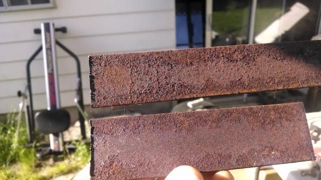

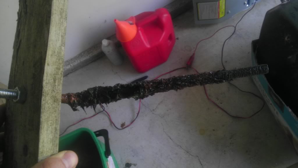

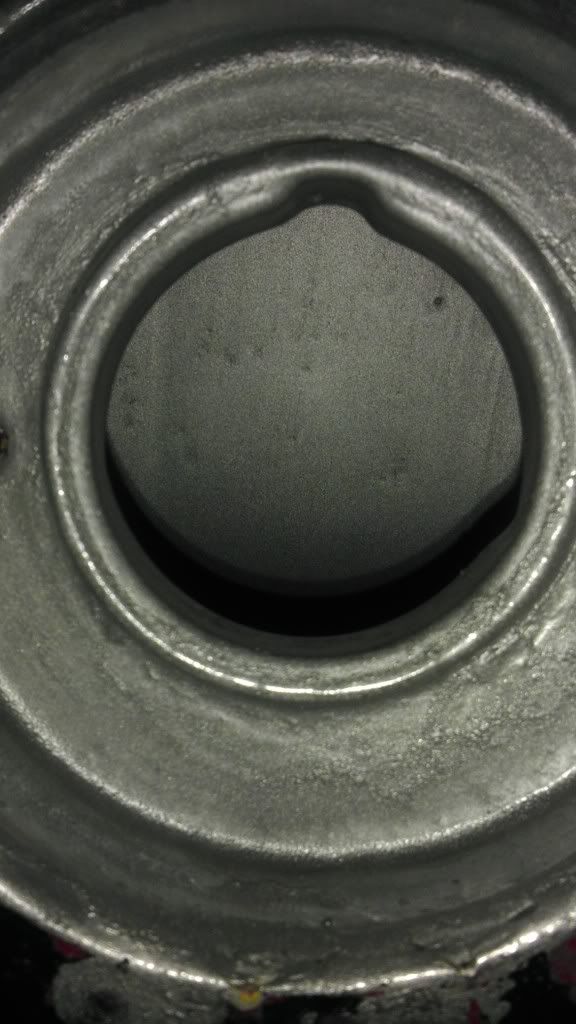

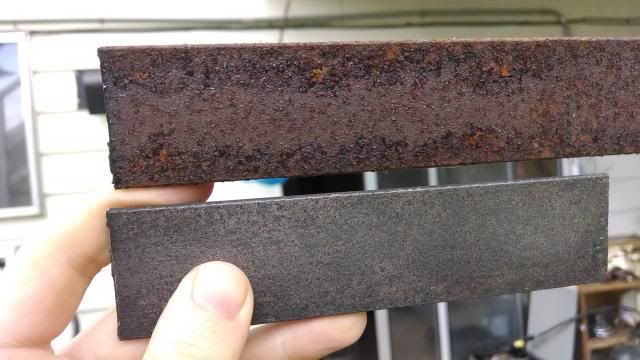

    I vote for electrolysis + POR15. The POR15 steps took me almost half a day to complete properly , but the results were excellent.
